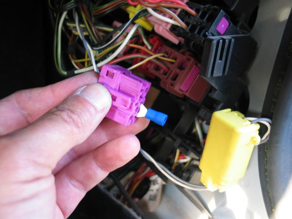

I read that the DRL resistor could be easily bypassed. This is handy if you install HID headlights, want to retain DRLs, but don't want to bother with a separate relay harness wired to the battery. Of course, simply unplugging this will also disable DRLs, so it's also an alternative to removing relay 173.
The DRL resistor is beneath the passenger side lower A-pillar panel. Pry off the cover, remove one Phillips screw, and you can remove the cover. It's held on at the top by a clip.
Beneath this you will see a number of connectors. The bright pink one at the bottom is the one you want (in my 2003 B5.5):
After unplugging it, you will need to jumper across the two leads open leads if you want full voltage for your HID DRLs. I used a simple "bayonette" crimp-on terminal. You can get these at any auto parts store, including WalMart. It fits perfectly!
Button everything back up and you're set. Once you have installed the jumper, you will now have full current available to your HID lights as DRLs. As an alternative, if you simply leave this connector unplugged you have disabled your DRLs.

Even so, because I have 3000K VVME HIDs in my OE fogs, I'll still have to bypass this resistor as I have recently found thet the VVME ballasts do not do well through the DRL resistor (I suspect their starting current is higher). In contrast, my McCullouch ballasts seem to do fine with it.

Now my DRLs behave as I wish: in the park position, they are off, allowing me independent fogs. In addition, because I've jumpered across the DRL resistor it will not longer cause problems limiting current to the HID ballasts.
