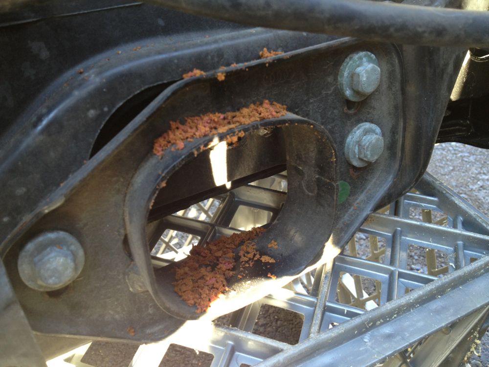

    I don't think anyone here is in a place to judge you for spending big $$$ on a 13 year old car - we've all been there...
    The loud bang sounds like the snub mount to me if it's only happening on stops/starts. Put the engine in gear and hold the ebrake up, have someone watch the engine for movement while you rev it up. The rest are easy fixes, window motor and headlights are easy enough to replace.

    Quote Originally Posted by TheColoradoRed View Post
    Yep, sounds like a snub mount. The snub mount is just a stout pin with a dense polyurethane foam cover that then fits into a slightly larger receptacle on the lower radiator support and keeps the front of the engine from torquing off center on the liquid filled side engine mounts, while still allowing for a little up and down movement.
    If yours has never been replaced, it has probably long since disintegrated away. That would leave the stout pin unprotected and able to move until the hard frame of the radiator support stops it with a loud klunk, or a bang.
    I also have a V6, and you can see my lower radiator support snub mount receptacle in this picture:
    Mine was only 9 years old and you can see the residue it was shedding before I replaced it with an APR dense polyurethane (not foam) snub.
    The pin the snub mount goes onto is the thumb sized stub in the bottom 7 o'clock position on the front of the engine:
    If that stubby pin has no protection, you can imagine the bang you might get when it hits the metal socket with force under acceleration.
    FWIW, you don't have to remove the front end to replace the snub mount, there are DIY how-tos on this site that will walk you through it. I had my front end off in this picture so I could to timing belt and cam cover gasket replacements.

    I'm not sure the American name for it, but it's the front most motor mount.
    Here's a link to help you out:
    DIY Write-up: Snub Mount replacement on B5.5 2.8 V6 (pics)
    Quote Originally Posted by keithwbloom View Post
    I think you actually do have to have it off, else there isn't enough room. There was one write up without bringing the car to service position, but the OP had previously replaced bolts the with smaller/easier accessible ones. So for the OEM bolts for a snub that hasn't been changed, there isn't enough room without pulling the front end.
    Yes. Protection is necessary.

    Well it definitely is snub mount. With hood opened n me hitting the gas w/ E-brake on, dam that motor can jump. Since I want this to be very performance oriented as I go on, I'm researching which 1s the v6 super charged boys like. I'm going make video of where pin is & how it moves when testing for bad snub so maybe it can help others. Gonna try to keep blog of wat I do for maintenance & repair. Just very new to posting on a forum so will be trying to learn. Also will be checking today for suspension wear.
